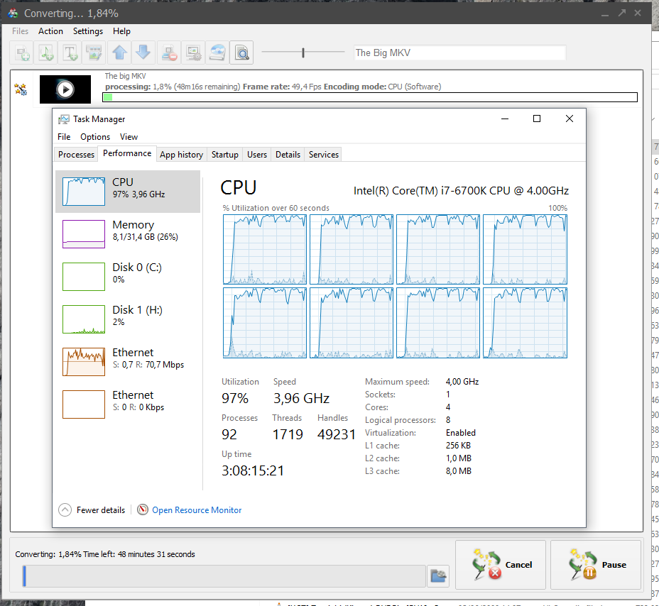

Sorry for the delay.
As you can see all CPUs are busy with this conversion from Blu-Ray to MKV.
Have you set the number of cores used for encoding & decoding in the conversion settings?
If you remux the video far less cores will be used.
Dependening on which hardware acceleration you use CPU can be nearly ignored.
I hope this answers your question.

Video decoding/encoding tasks can be distributed to all CPU cores only if CPU decoding/encoding is used.
I mean if you enabled hardware optimizations, CPU cores will only be used for audio chain process (and audio treatment can only be done by 1 core at a time).
Can you give us your hardware optimization settings? Or maybe send us your last log file...
I have tried both with and without hardware optimization, nothing changes.
In both instances (with or without HO), kernel time, core usage and NUMA node usage remains the same.
This also applies simultaneous conversions, 1-12 it makes no difference in kernel time, core usage and NUMA node usage.
I have not found any setting that affects core usage, 1 cpu is always used much, much more that the other and the % usage is always as I quoted in my prior post.
Attached is the log file for the settings - 32 core decode, 32 core encode, 1 simultaneous conversion, hardware optimization OFF
I see nothing in the file pertinent to the problem, beyond the fact that the Xeon cpus are mis-identified as a single 32/16 (?) unit, when there are actually 2 12core/24thread units.

Can you try by disabling all audio and subtitle tracks?
I would like to know if the speed is not lowered by audio/subtitle processins...
Another question: is your source/destination folders are on a quick drive (not a network or USB stick)
Did you tried to change the cor(s) setting to 24?
Re: Is it Possible ?
Encoding takes less time and kernel time, core usage and NUMA node usage go down across all cores.cedric wrote:Hello,
Changing from 32 to 24 cores simply lowers kernel time, core usage and NUMA node usage, but it does not change encode time, since the cores are not being used at anywhere near capacity.Another question: is your source/destination folders are on a quick drive (not a network or USB stick)
Simple question - Is the program SMP capable or not ??
If it isn't, this is all a waste of time.
