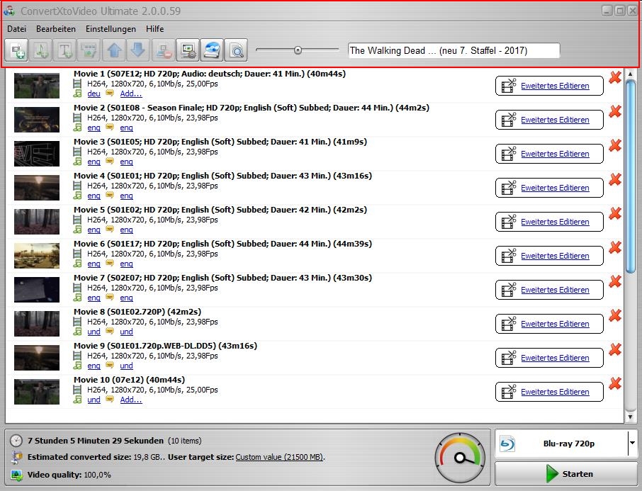

Now not all mkv files are launched together, only one after another (--> as you told: "Conversions will be launched as allowed by free RAM". See Screen 1
So I can at least convert 8 files simultaneously.

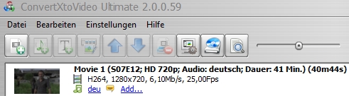

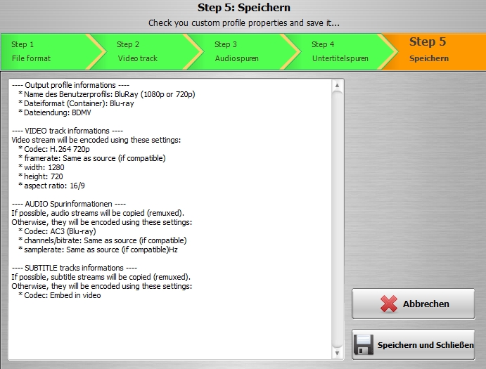

During conversion upper part of window is "changing" (but no crashing; but after conversion has finished, to close window is not possible anymore). Compare Screen 2 und 3 (screen 3 = "original")

mue.mat wrote: During conversion upper part of window is "changing" (but no crashing; but after conversion has finished, to close window is not possible anymore). Compare Screen 2 und 3 (screen 3 = "original")
This is a bug we've have for some time. The main issue is that although we know the issue exist, we've had troubles reproducing it. Next time it happens, could you send us a bug report with this thread in the message.

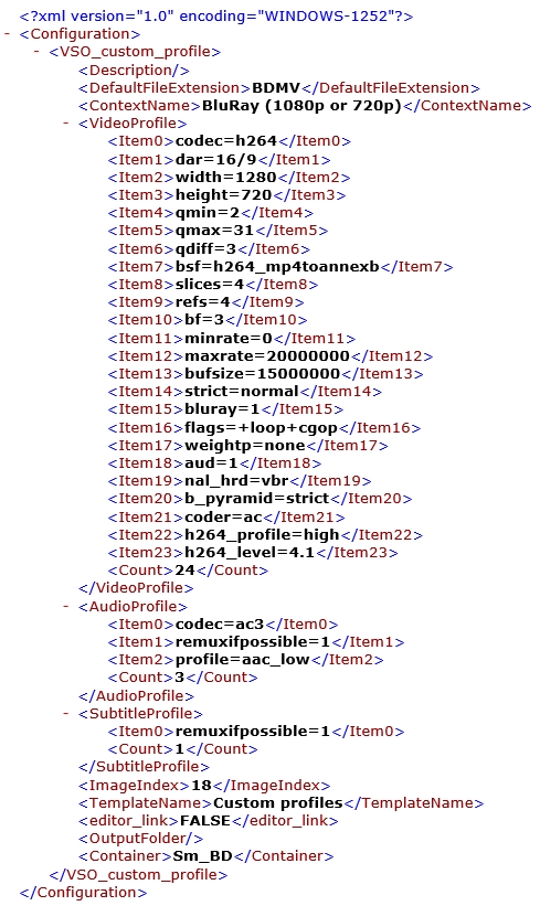

I think I was not clear, what I would like is the actual profile. You can find it here: C:\ProgramData\VSO\ConvertXtoVideo Ultimate\2\custom_profiles

I see ...
Here we are.
mue.mat

mue.mat wrote:See attached jpg-files:
A mkf video file with 25Fps is converted into BluRay structure with 24 Fps, but only if I'm using Custom Profile.
This bug happened as well in v2.0.0.47, but was fixed in v2.0.0.48.
Meanwhile this bug occurs again.
mue.mat
This issue will be fixed in the next build
