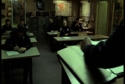

Using the latest version 2.0.0.70 and getting a strange issue affecting the top of the converted video.
Its a dvd with tv episodes and i'm converting to mp4 x264 with aac
It converted in no time with nvenc and at first i thought that was the problem but it does the same in much slower software cpu mode.
I also extracted the files from the dvd thinking it may been cos it was encoding from an mounted iso
The dvd plays fine and just seems to be when i convert with convertxtovideo
I will try Handbrake a bit later and see if there is any difference.
Any ideas ?
Quick update - no anomaly with Handbrake.
Another update - I tried a different interlace method (merge) it was set to vso before .. still corrupt in same spots on dvd
I then tried no interlace at all and again its corrupt in same places.
No idea whats causing this but i will have to go back to Handbrake for the time being as i needed these discs converted this weekend.
Only thing i can think of is a setting in the profile (MP4 x264 AAC) is causing this ? Its not a custom profile.

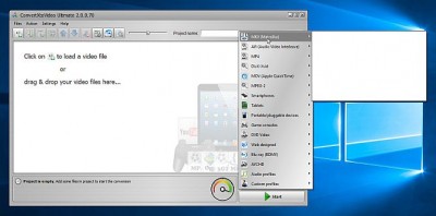

Not sure if its related but when i was selecting profiles the menu selection cleared so you could not read them (i will try and post a screenshot of it)

PS screenshot of profile selection I mentioned in the previous post

I still have menu options appearing blank, and other odd things with the interface, like the quality factor being way off (default appear to be set to high or something unless one changes it to something else then back to default)
