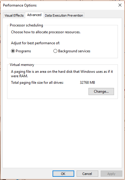

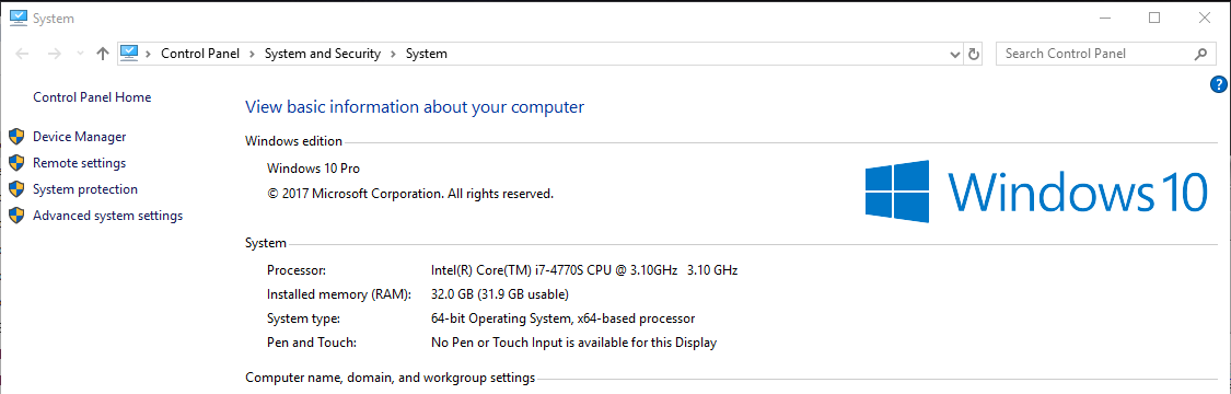

I'm running ConvertXtoHD 3.0.0.52 on a Windows 10 machine with an Intel i7-4770S, 32GB of physical memory, an additional 32GB of virtual memory on an SSD, and a 4GB NVIDIA GeForce GTX 1050Ti GPU. My conversion - an eight episode TV season - consistently bombs on the eighth and final video. I have performed the following troubleshooting steps:
- Disabled hardware optimizations
- Tried different hardware optimizations
- Turning off every non-critical application and background service/process
- Reduced the number of simultaneous conversions, all the way down to one
- Reduced the output resolution to 720p*
- Downgraded to 3.0.0.40
- Reduced output video quality*
- Tried two-pass encoding
- Completely uninstalled (including registry wipe) and reinstalled ConvertXtoHD
- Replaced the eighth video with a different version
* I don't consider these to be acceptable long-term, but I did them for troubleshooting purposes.
The program is pretty much unusable now. Nothing has changed on my system. I've burned dozens and dozens of BDs previously, but it's been a while.
