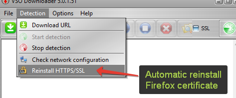

Downloader can automatically reinstall this certificate in Firefox.
Automatic reinstallation of Firefox certificates

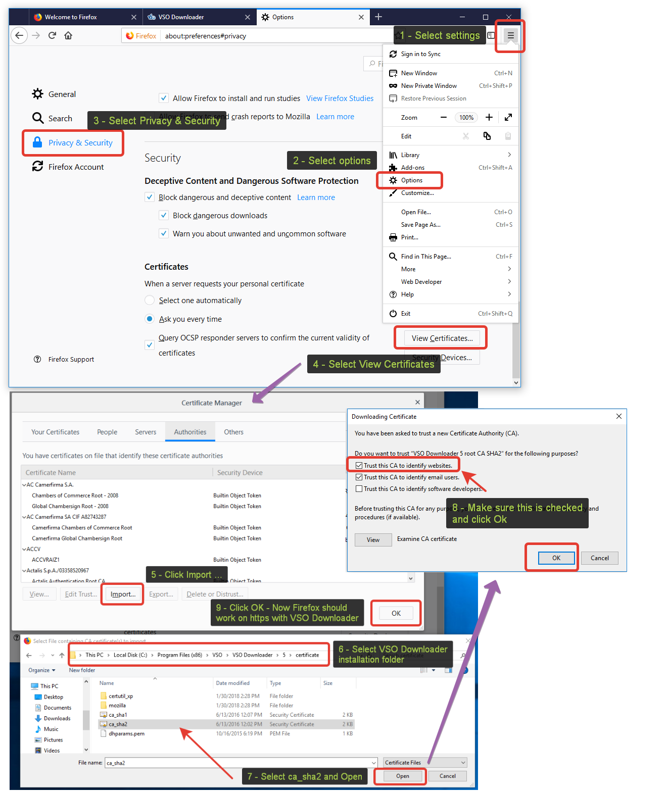

However, in some case, the automatic reinstallation of the certificate doesn't work.
To fix the situation, the VSO Downloader CA certificate must be reinstalled in the Firefox certificate store manually.
This is done with the following procedure (click on the image below to expand / save it at full size ):
How to install VSO Downloader CA certificate in recent Firefox after an update.
1 - go to Firefox Settings menu
2 - Select Options
3 - Select Privacy & Security - on some firefox version, it might be in Advanced, section Certificates
4 - Click on View Certificates ... button
5 - Click on Import ... button
6 - Select the subfolder 'certificate' in VSO Downloader installation folder (typically "C:\Program Files (x86)\VSO\VSO Downloader\5\certificate")
7 - Select certificate ca_sha2, and click Open
8 - Make sure to have Trust this CA to identify websites. checked, and click OK
9 - Click Ok, close all Firefox Options windows / tab
Once this is done, https support in Firefox for VSO Downloader should be available again.
