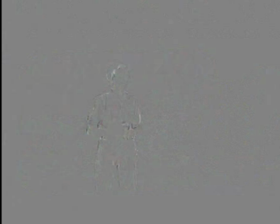

Why does generating DVD with ConvertXtoDVD 7.00.64 appear in image conversion in light gray looking like image negative? See attached image.
This happens using standard HEVC 265 files with resolution: 720x480, 29.97 fps and bit rate close to 2000 kbps.
error generate DVD with files standart H265 - image negative gray
Capturar pb.PNG (61.6 KiB) Viewed 14690 times
Re: HEVC Format - Supported?
Post conversion log, then tell more about where that happens and does it happen only with one file?
Ok, there seems to bug in CxDVD7 or it just needs updating.
Your sample file is done with QuickTime and uses slightly non-standard encoding:
  • Metadata:
    major_brand : qt
    minor_version : 512
    compatible_brands: qt
    encoder : Lavf55.33.100
This is from working x265 file:
  • Metadata:
    major_brand : iso4
    minor_version : 1
    compatible_brands: iso4hvc1
Also you can see in preview that first picture is good, but when you try to preview more it causes this grey picture, which is actually just parts of video that have changed since last full frame.
This example is using very tight packing and might actually break x265 rules just to get it in smaller size. Plays fine but really hard to convert.
I did not find more information about what are "standards" for x265 so VSO needs to handle this.

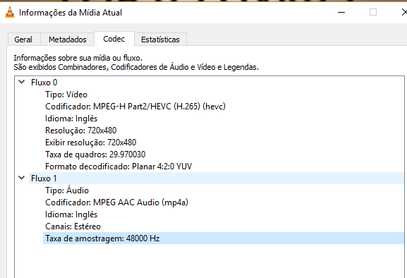

JJ wrote:Actually that sample file of yours crashed VLC player so that I had to kill it as it was not responding.
So there is something on that encoding of that file.
This file is normal in VLC Player 2.28 view. standard H265 Larger file data is in the attached image.
