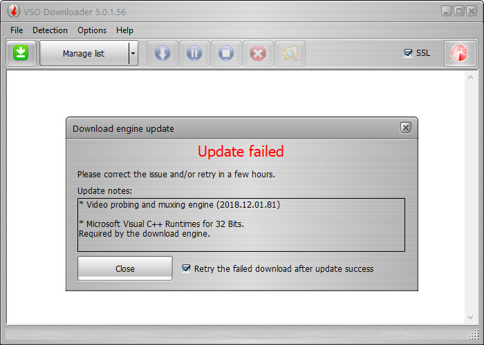

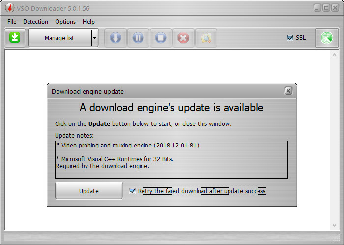

See attached... am I missing something?
After
After
Before
Before

I've been getting this error too, time after time, for days.
I'm running VSO Downloader 5.0.1.56 under Windows 10 Pro x64 1809, but this error occurred under 1803 also, not that that's surprising in any way.
I almost submitted a report via vsorep.exe, but there are no logs for VSO Downloader, and I'm not comfortable sending God-knows-what info via a special utility like that.

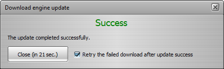

Set VSO DL to "Run as Administrator" and the update will run successfully. You can then run it normally (not as Admin) and everything will work. This is a known bug and a fix will surely come eventually, but for now, this seems to do the trick. Worked for me, at least.

Thanks Bron This seemed to work - set run as administrator. I had to wait several days between attempts as this "update" message is not consistent. Thanks much on that.

So the software was by default trying to access restricted file system objects, and the fact that this would cause issues was a surprise...
And the workaround is to grant admin access to an application that can download content automatically in the background...
It worked, thank you, but this is not a mild bug nor workaround. If you employ this workaround, the first thing you should do is disable automatic detection. And close/restart VSO Downloader as soon as the update is complete.

Now I'm having a related issue: I hit "Update" when running VSO Downloader as admin, it reports success, but when I restart VSO Downloader, it detects the update all over again.
Posts: 5615
Re: Error
roiled wrote:Now I'm having a related issue: I hit "Update" when running VSO Downloader as admin, it reports success, but when I restart VSO Downloader, it detects the update all over again.
Are you using v5.0.1.58 ?
