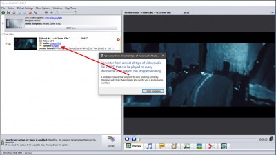

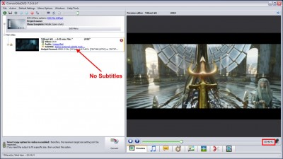

It appears to me that the issue is being caused by the subtitles. I have tried to reproduce the problem using the same movie , with and without subtitles. See pictures.
This version of CX7 has been issued twice. This bug has not been present in the first issue. I have tested the first issue using the same movie with subtitles and it played fine in the preview window.
The pictures show the application with and without subtitles.

I tested version 7.0.0.67, second issue with a movie and a subtitle file using the preview player and that crashed the application.
I then tested version 7.0.0.67, second issue with the same movie but without subtitles and that played fine.
The day before, I tested version 7.0.0.67 first issue with the same movie and subtitles and there was no problem.
I think that the problem is not in the subtitle file. It is in the player of version 7.0.0.67 second issue.

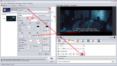

I think that for multi line subtitles, when you have 3 lines or more, you will have to set middle number higher then the default one. Or perhaps you can reduce the font size.
This can be done in the Subtitles style editor.
Try and experiment with the settings of the Subtitles style editor.
