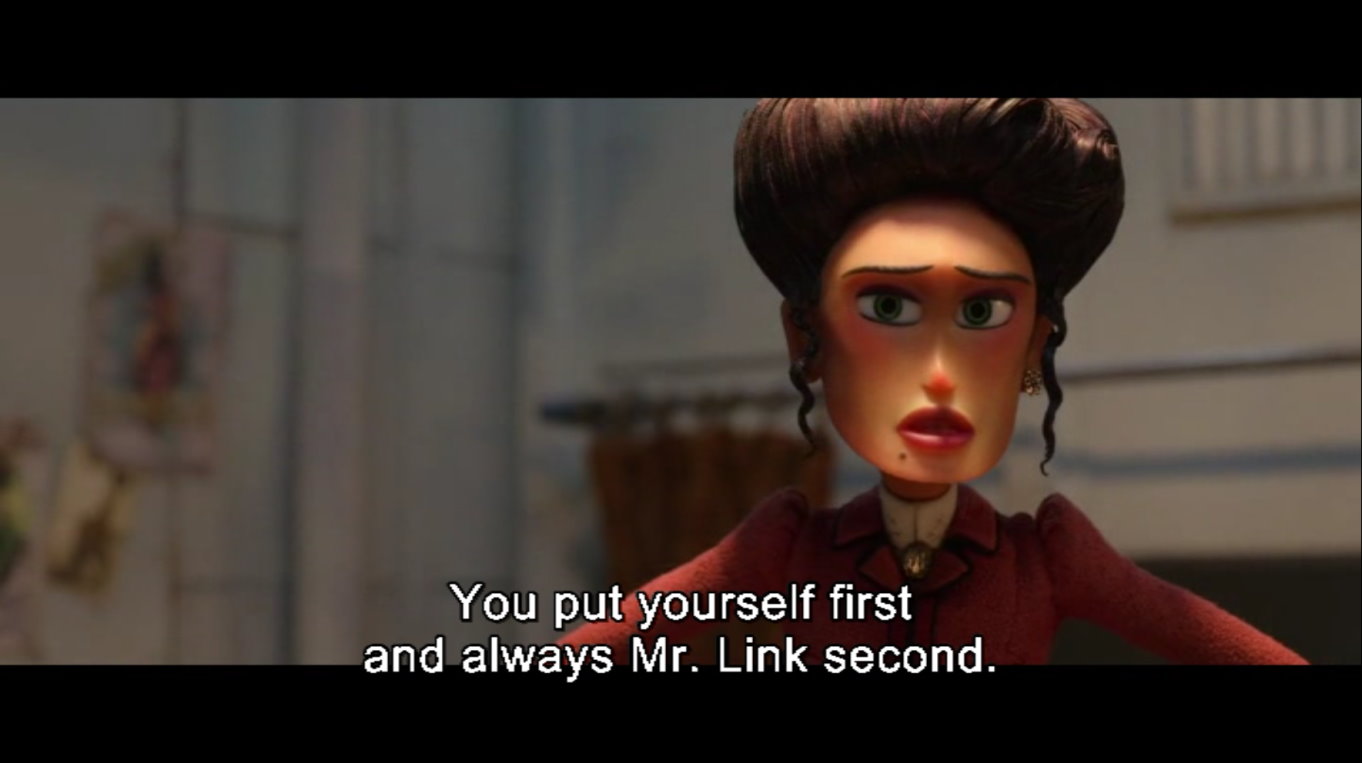

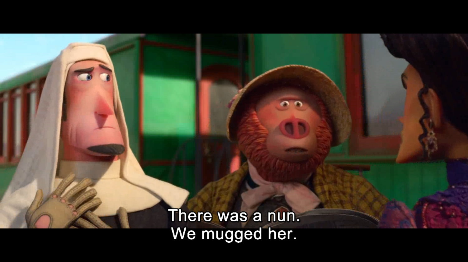

I have just made a test conversion MP4 to MKV --> DVD. Subtitles are working fine here.
Default Settings.
Top Attachment: MKV Hard Coded
Bottom Attachment: DVD Subtitles

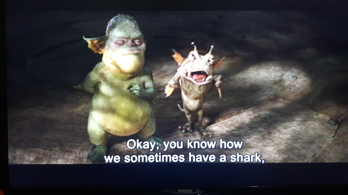

I shall try a conversation from MKV to Blu-Ray.
No problems here with MKV to Blu-Ray 576p and 1080p
Sorry about the quality of he picture PowerDVD does not allow screen capture from Blu-Ray
