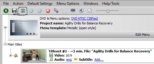

Sorry to bring up an 'old' issue for me, but I solved my issue. It's all in the setup. In the past, when adding more 'episodes' I always click on the top ''left' (+) plus sign. This way, it converted 'two' episodes at the same time, therefore the process was faster. Apparently, sometimes, the issue that I had would sometimes happen. To resolve my problem, I, instead, clicked on the 'third' icon from the left, "merge a multimedia file". This causes the video files to be converted one at a time. The issue was resolved.
In case anyone is interested, here is a log and a capture.
Hope this helps.
