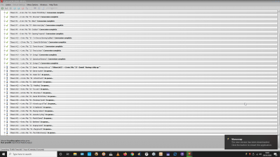

Conversion gets stuck

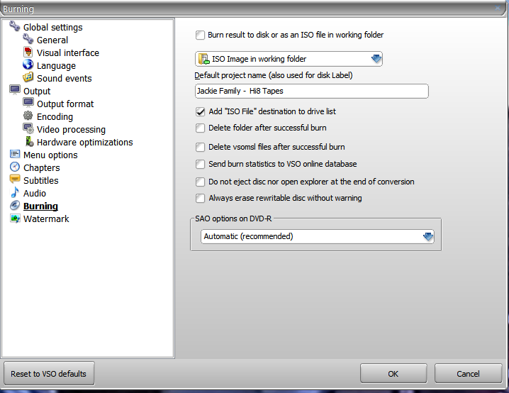

any thoughts ? strange thing is, with the selections made in the BURN window, would have thought an ISO file would have been created burn it wasnt ??? which is again why I think the options in the BURN screen are ambiguous
- Posts: 60
- Joined: Wed May 27, 2020 12:13 pm
Re: Conversion gets stuck

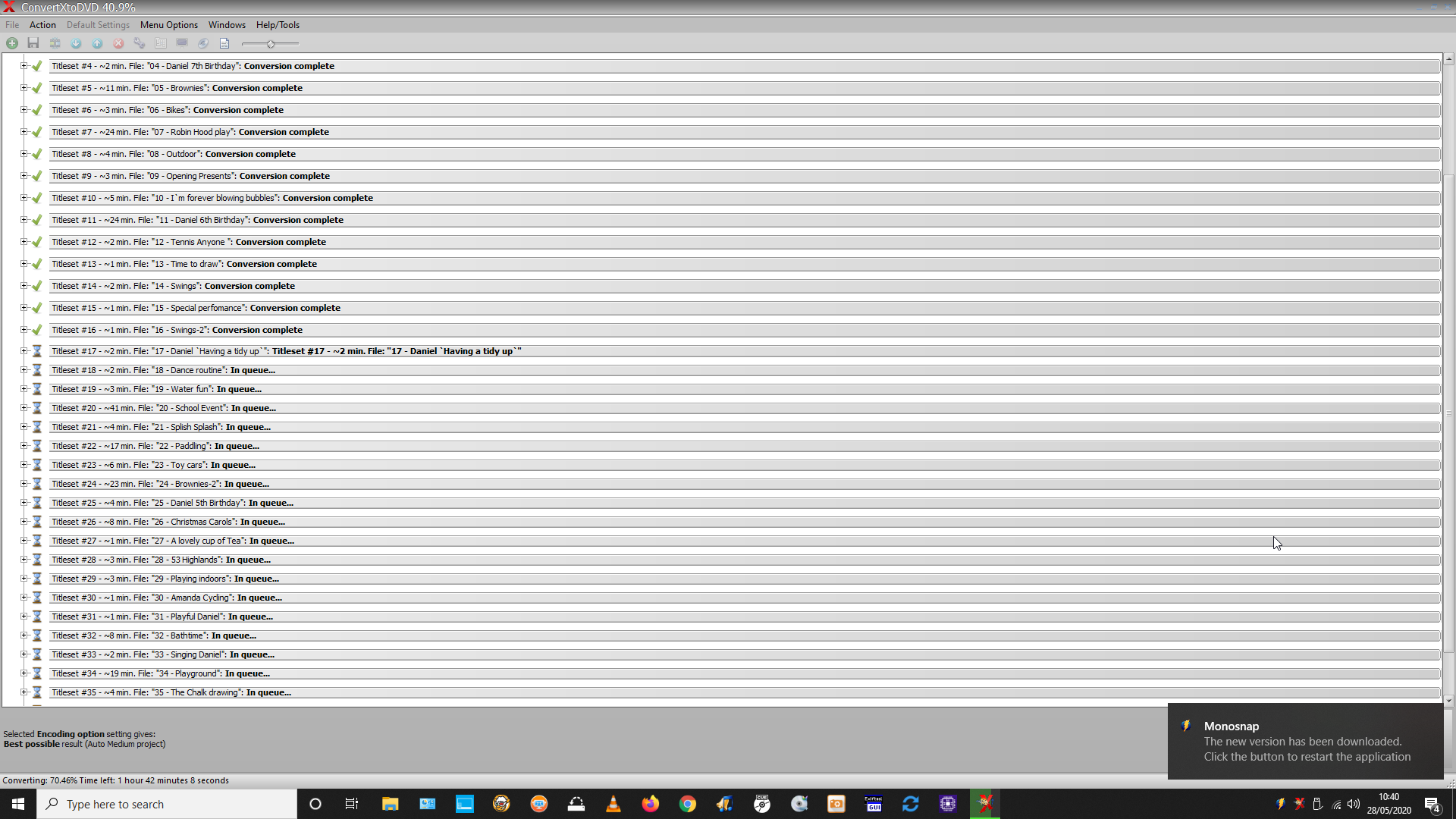

In the absence of any replies, I simply kept trying different ideas. Last night I turned off Hardware Optimisation ( does this mean “optimisation” & improves quality ? Or is it simply a different method of conversion as opposed to software ? ) also changed conversion priority to Normal, maybe changing this to normal instead of highest makes a big difference to the success of the conversion ? Still had it on 2 pass, as I am advised this improves the quality. The burning options were ‘ISO image in working folder and Add Iso file destination to drive list, but it created a TS Video folder and NO ISO ?
As a matter of interest I also,looked at Hardware optimisation, although in VSO post it was referred to as Hardware acceleration
according to that post, sometimes the HW Option gives better FPS than the CPU Option....apparently it is necessary to start a conversion at compare the FPS with each setting, would have thought there could be a tool built in to CVXtoDVD which calculates The best option for the user, by running a dummy conversion, which should only take a minute to run & would be a once only action, or it could be ran in the background and Message in the HW window providing the best CPU or HW...
So strictly speaking it is optimisation.....the other strange thing is, I chose HW optimisation, to test the FPS, but the conversion showed only 4.7 FPS in the individual title, but said CPU NOT hardware, so I disabled HW optimisation amd it still showed CPU , so no idea how to do a comparison thanks

1-HW optimisation, shows same FPS during conversion as CPU, have nviida GPU, need convertxtodvd to determine if HW or CPU best.....
2-Does single pass lose a lot of quality as opposed to double pass
3-Burn screen options confusing, tick ISO creation and ISO in file list, but only creates a TS folder ???
4-trimming function definitely seems to cause problems in conversion , needs correcting....maybe ask If https://www.videohelp.com/software/LosslessCut Could allow VSO to use their algorithm in convertxtodvd for a fee.....
