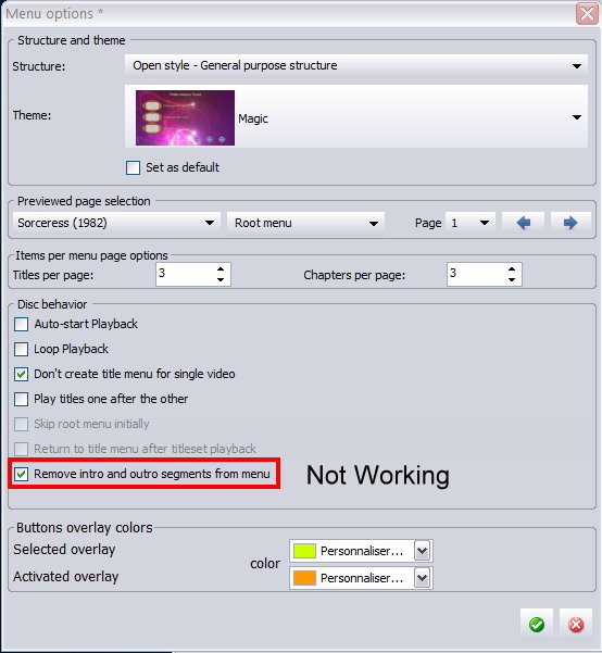

Re: Question about running a project
To disable the menu animations go here
Please note that in the most recent version disabling the animations causes the buttons overlays to stop working.
This is a new reported bug.
In any case, I suggest you use a past version from here:
http://download2.vso-software.fr/archives/cxd/v7/
