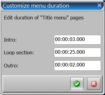

The default setting is:

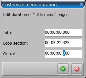

When I create a DVD menu, I always set the 'duration of Title menu pages' like this:
As you see, 'Intro' and 'Outro'are both set to: 00:00:00:000

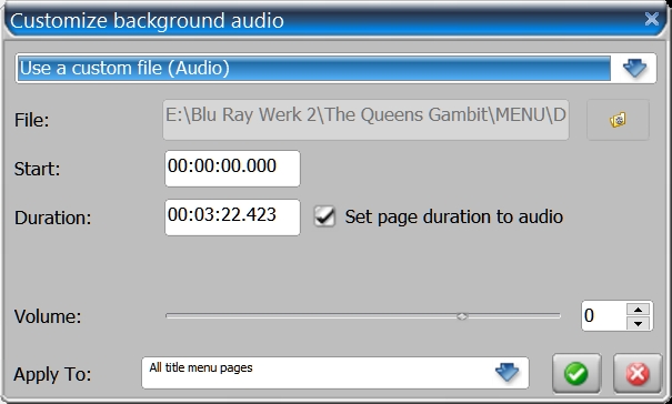

The 00:03:22:423 is the 'loop section' and is a song that I use for the a
project I am working at this moment.
So this can vary depending of the lenght of the audio file I use.
Like this:

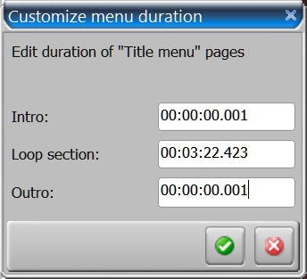

In the 'Customize menu duration' the Intro and Outro values can't be set to 00:00:00:000
When I set the Intro and Outro values to 00:00:00:001 the menu workes fine:
