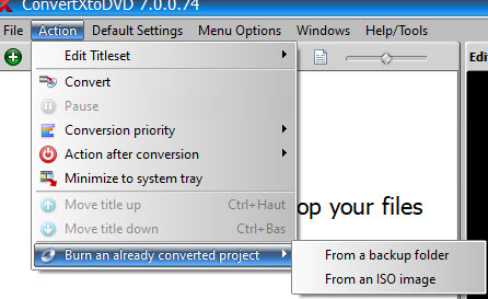

Posts: 216
Re: How to burn already converted files without having to convert again
Go here. Only works if you have not set option to delete files on completion
Posts: 6343
This can be used with any folder containing Video_TS, you can copy from existing DVD whole folder to computer and then from CXD select this folder to burn.
