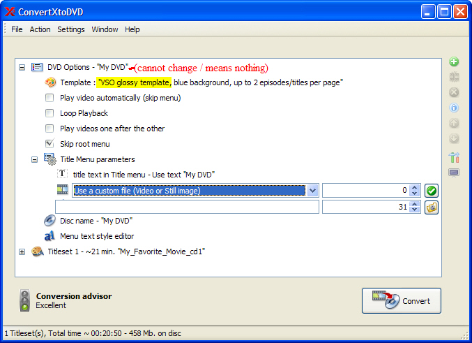

To add a background image to your main DVD menu the (title menu, where all the video files you converted are listed)
a) add you videos files to ConvertXtoDVD that you want to convert
b) click on the "+" next to: DVD Options - "My DVD"
c) double click on Template and select the type of menu you would like to use. Once selected click on the green check mark on the right. ("default, simple menu" will not apply background image- chose a different template)
d) click on the "+" next to: Title Menu parameters
e) double click on: Background video in Title menu
f) use the drop down to select Use a custom file (Video or Still image)
browse to the image and click ok, and then click on the green check mark on the right.
g) beneath this you can select a custom audio file to play if you want. (In the tiltle menus of most templates by default no audio we play.)
h) if you want your root menus to have a background image as well follow the same procedure under each of the files you have added to be converted by clicking on "Menu parameters".
***Currently there is no preview of what your menu will look like before the conversion process (i.e the preview window will not load the image file you selected). A menu preview will come in a future version

Following this guide to add background image, when double clicking on Background Video in Title, this action produces no other option to add it.

Posts: 5615
Press + and open all the options under your input file.
Then you will see:
+Menu parameters
+Background video in several menu pages.
Background video in Chapter menu - Use template default
Background video in Root menu - Use template default
Background video in Audio/Subtitle settings menu - Use template default
Press <F2> on any of those, and the option will appear !

i am also using this version and am unable to double click 'background video in title menu' - no drop down appears
Posts: 5615
Use the <F2> key to go in edit mode !
Select then give just a single click.
It could be easier. :)
that worked! thanks!
