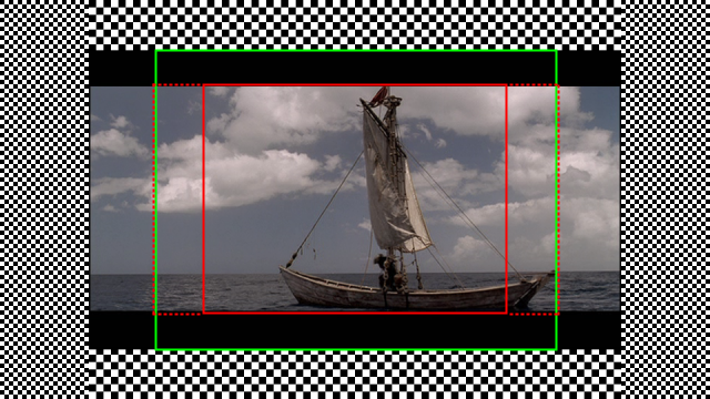

Letterboxed Widescreen Conversions
The rest of this post will be about cases with source AR > converted AR. The user can hopefully use information above to infer what happens when source AR < converted AR. Experimenting with different sources in the video editor is the best way to learn, but, hopefully, information given here will help.
The image below shows a typical movie originally filmed at the popular AR of 2.35. When that movie was put on a commercial DVD, it was letterboxed to a 16:9 = 1.778 AR by adding the black bars shown there. If that movie were available on the internet for download, it would have been ripped from the DVD and re-encoded to a file format such as avi or mkv that allows higher compression and therefore smaller file size. The person that did the re-encode could have left the black bars in the video (letterboxed version) or removed them (film version).
I would personally Letterbox this movie to a 16:9 AR regardless of the version downloaded - the black bars would be restored for the film version and nothing would need be done for the letterboxed version during conversion. Then it would play the same way as the original commercial DVD would on either a 4:3 or 16:9 TV if the player settings are correct (Letterbox view mode for 4:3 and standard for 16:9).
Problems with Letterboxed Widescreen Conversions
Some people believe, mistakenly IMO, the converted AR should be set to the AR of the TV they will watch the converted video on. And, in some cases, when a user has a problem displaying a 16:9 letterboxed video on a 4:3 TV, usually because of incorrect player setup, they are advised to convert the widescreen source using 4:3 letterbox.
Let's look at how a widescreen letterboxed movie should display on different TVs. Referring again to the image below, the 16:9 letterbox with only the black bars will display on a 16:9 TV as shown. In other words, those same black bars will show on that TV (they are a permanent part of the video). When that video is played on a 4:3 TV with the player correctly set in Letterbox view mode, the player will automatically add additonal black bars represented by the coarse checkerboard areas, the same would be done with a commercial widescreen DVD of the same movie.
Now, if that movie was converted to 4:3 letterbox, permanent black bars equal to the black bars shown in the image plus the coarse checkerboard area would be in the converted video. Such a video will naturally play without a problem on a 4:3 TV even if player setup is incorrect, sometimes promoting the idea that this is the necessary solution for widescreen movies on a 4:3 TV. But nothing has been gained since the two letterboxed conversions will display the same if player setup is correct. And, if the 4:3 letterbox conversion is ever played on a 16:9 TV, the player will have to add black bars on the sides represented by the fine checkerboard areas. The result would be a small movie in the middle of the screen as shown in the image.
Pan-Scan Conversions
Let's look at a few Pan-Scan possibilities.
The red rectangle in the image below represents a 4:3 Pan-Scan conversion of a film version download (source without the black bars included). Such a conversion would be similar to a commercial DVD labeled as "Fullscreen version".
The red dashed rectangle represents a 16:9 Pan-Scan conversion of that download. It would display full screen without black bars on a 16:9 TV but the same could be achieved by zooming a 16:9 letterboxed conversion. It would display roughly the same as the green rectangle on a 4:3 TV with the player in Letterbox view mode - see the following comments about it.
The green rectangle shows a 4:3 Pan-Scan conversion of a letterboxed download with black bars included. The same would be displayed if a 16:9 letterboxed conversion was played on a 4:3 TV with the player in Pan-Scan view mode.
A 16:9 Pan-Scan of the letterboxed version would have no effect of course because the source already has a 16:9 AR.
I can't personally find any benefit for Pan-Scan conversions.
