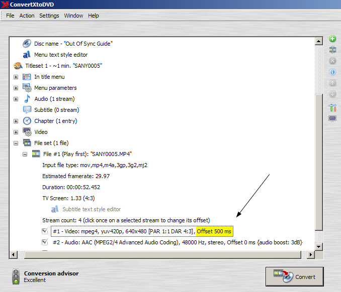

Step 1
Open the +File Set on the bottom, and not the +Titleset above.

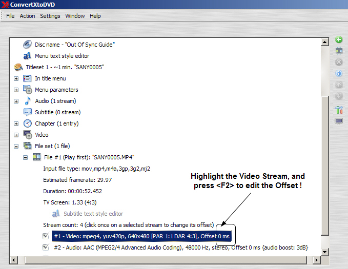

Step 2a
With the mouse, HighLight the Video or Audio Stream, the stream you wish to add a delay.
Step 2b
Press <F2> to edit, then set the needed value with the arrows, or manually (200 <enter>)

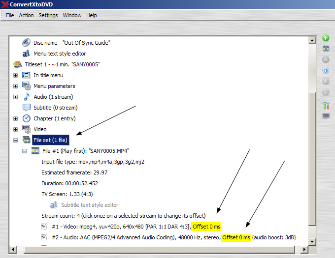

Step 3
Just click anywhere else, away from the selection box.
It will close the value editor.
Now, you can see the new value.

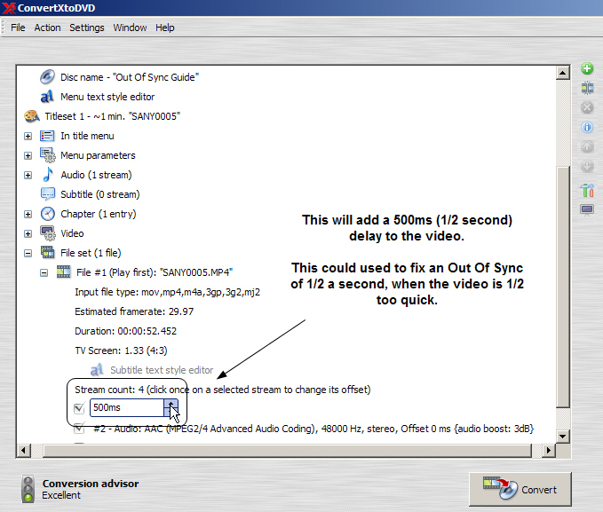

This is a hit and miss thing.
Try with a 500ms delay, if it's too long, reduce to 300ms and test again.
Step 3.jpg (225.86 KiB) Viewed 19541 times
Step 2b.jpg (250.34 KiB) Viewed 19541 times
Step 2a.jpg (222.85 KiB) Viewed 19540 times
Step 1.jpg (203.75 KiB) Viewed 19540 times
